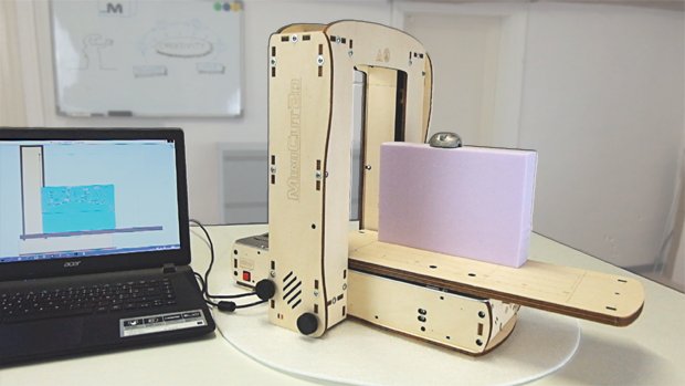

MiniCut2d is a computer controlled machine that works with it’s own software. The motion of the cutting wire is represented by a single continuous line through the rectangle of the material.

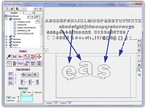

The first project is very easy to do : just create your personal continuous line by dragging letters of the library.
Un logiciel intuitif.Then put a block of material on the plate, and you’re ready.

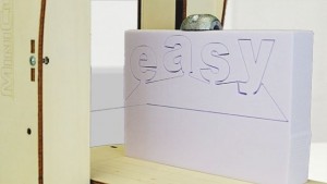

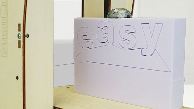

Now it’s time for you to cut…
With MiniCut2d, you have only to set up the heat of the wire to have a 1mm groove, save it for future usage, and launch the cut. The wire will heat and move. And the material will meld on its path, with no effort, no noise, no dust.
Le fil ne touche pas la matière, qui fond avant.It take between 4 to 20 minutes, depending of your project. Then your 2D line on the screen becomes your 3D project in our hands. And it looks exactly like on the screen, with a direct surface finish.

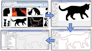

For more personal and quick projects, we coded a terrific vectorization process. MiniCut2d Software will recognize the outline of every contrasted picture. It opens to you an infinite number of fast creation possibilities :
  • Pictures from Internet (keyword : « silhouette »)
  • Manual drawings (then photo or scan)
  • Drawings and letters in word processor softwares (then « printscreen » key)
  • Every drawing software (.jpg, .bmp…)
More than one piece ? Connect them with a black line. You can correct the errors with white if needed (correction fluid on manual drawings, white shape on screen).

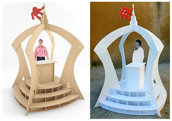

But the MiniCut2d can take you further. If you want to learn CAD softwares, our machine will still be there, as a leverage for your motivation and a fast process of fabrication. Its’ software is able to open DXF files, a common exchange format for CAD software and vector graphics editors. FreeCAD, NanoCAD, AutoCAD, Illustrator, Inkscape, 123DMake… whatever software you choose to learn, you will be able to export your production in DXF files. And use it with the MiniCut2d.
Maquette de kiosque pour une exposition.

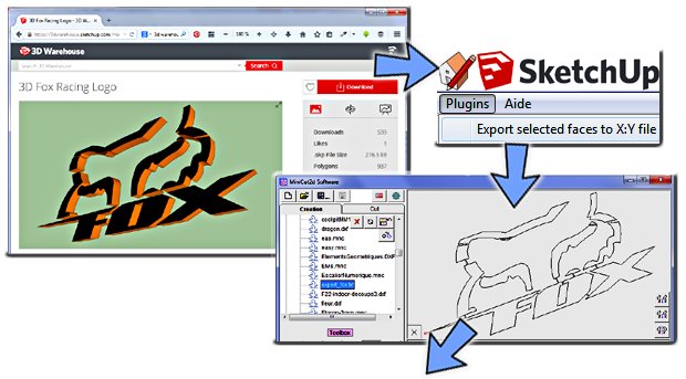

SketchUp is one of the most famous 3D CAD software for beginners to experts. When you will be ready to use it, a free plugin will allow you to export your work in MiniCut2d’s library. We made this plugin for you, and it gives you acces to all of the shapes of the Trimble SketchUp Warehouse.
Export depuis SketchUpDécoupe d'un logo à partir de SketchUp

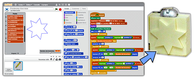

An maybe one day you will start to learn – or teach – how to code a software. With a very simple TXT file format, MiniCut2d will give you the opportunity to make your own shapes editor. We even propose on our website an easy way to use Scratch – the MIT free software for young coders – for create these files.
Découpe à partir d'un programme Scratch

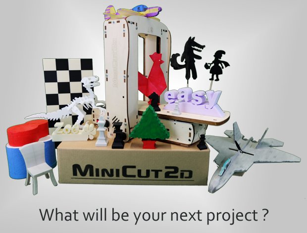

What can I make with my MiniCut2d ?
Here are some examples. (You can find more pictures and videos on hotwireproject.com.) But with creativity, only the sky is the limit !

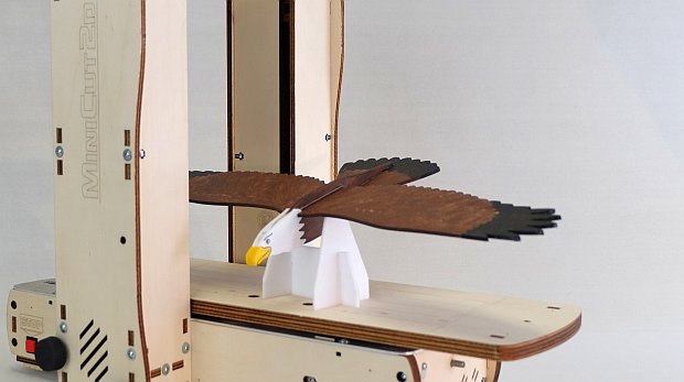

  • Planes hand launched, RC-planes
Aigle qui plane vraiment.

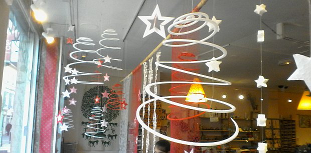

  • Decorations by theme : Christmas, Halloween…

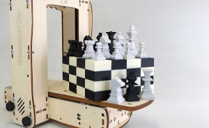

  • Original set of chess characters
Imaginez votre propre jeu d'échec

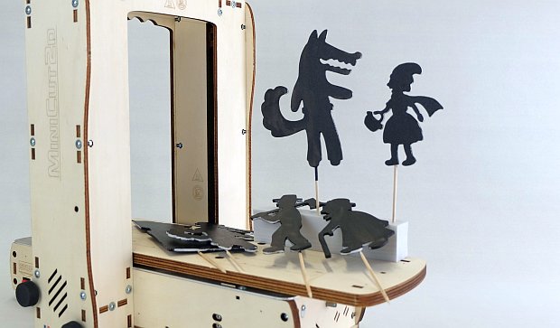

  • Shadow theaters
Tous les contes en quelques minutes.

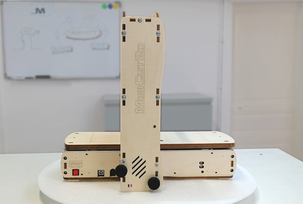

A reliable, portable and foldable machine
Because MiniCut2d use a simple process, settings are fast, simple and durable. The solid motion mechanics has no expendables parts and you don’t have to re-set up the machine every day.
Its size is designed to fit on your desktop, always ready to use. A handle allows you to move it safely, and it can be folded to be carried in a suitcase, or stored in a drawer.

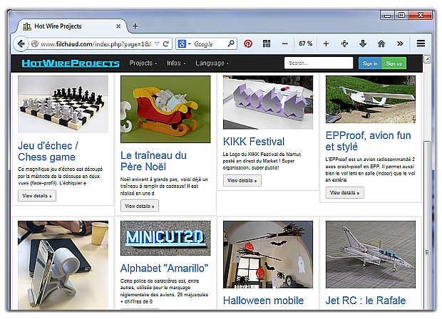

You can share your projects
When we designed MiniCut2d, creativity was one of our main concerns. But we wanted to propose a useful bank of ideas for launching the new users. So we created www.hotwireprojects.com, an interactive sharing website with an open source structure.
It allows you to find ideas or make processes, and to easily share your creations with your friends and other owners of MiniCut2d.
filchaud-com

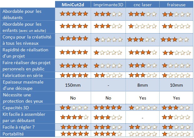

MiniCut2d face to face with other machines
tableau_comparatif_fr
To sum up : easy-to-access, fast, creative oriented, learning and teaching oriented, no dust, easy to store and move, durable, and great for making various projects for everyday life.

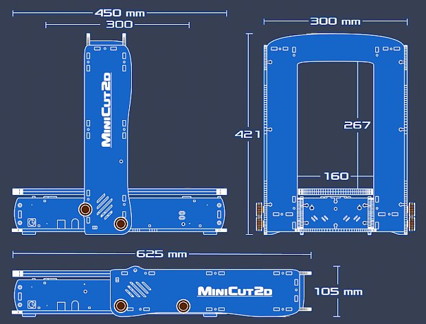

Technical specifications :
  • Unfolded dimensions : 450mm x 300mm x 420 mm
  • Folded : 625mm x 300mm x 105mm
  • Weight: 3.7kg (power supply and cord included)
  • Working volume: Lenght: 300mm, Height: 264mm, Thickness: 156mm
  • Voltage AC power supply: 100-240V at 50/60Hz
  • Continuous electrical output voltage: 12V
  • Max output current: 5A
  • USB connection
TriptyqueMiniCut2d is not a plastic molded machine. The v1.2 is assembled by nuts and bolts and can be easily opened. The benefit is double. First, it allows us to product the kit ourselves with all the mechanicals parts coming from Europe, and with only a reasonable delay. But we think that another important thing is that you will able to easily open your machine, to see its inside and understand how it works and how it was designed.

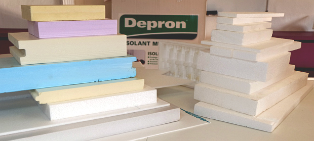

Where do you find the foam ?
MiniCut2d is designed to cut hard polystyrene foams. Polystyrene foams are insulation materials and you will find them easely in material stores at very affordables prices. You can also recycle packaging polystyrene parts.
Il existe de nombeuses sortes de polystyrène.
  • The extruded polystyrene is strong and smooth, and when it’s painted, it looks like plastic, or like wood. It’s available in many colors and thicknesses, called Styrofoam, Styrodur…
  • The Depron® is polystyrene extruded in white sheets of 3, 6 or 10mm thickness. It’s a wall insulation material that is generally stored at the paint and wallpaper section of the stores. It’s often used for airplane models and can also be found in the RC parts stores.
  • The expanded polystyrene is made of small balls. It’s the cheapest, but not the smoothest. It can be found in material stores or in packaging.

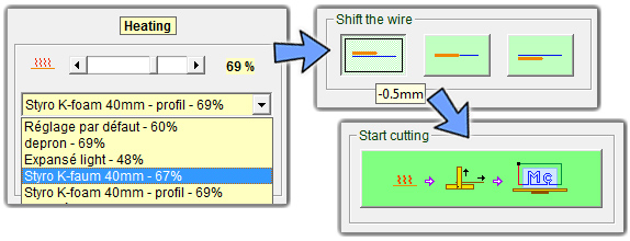

What are the settings for a cut ?
Thanks to our huge experience in hot wire machines, we were able to invent a single setting process : you just have to set up once the heat of the wire. Follow a 2 minutes procedure, to obtain visually a 1mm groove. Save the value for later, and that’s it. Every time you use the same material, you’ll just have to choose the name in the list.
Technically : With MiniCut2d, the cut is done at constant speed of 4mm per second. Because the groove of the wire is 1mm large, the toolpath will be offset by 0.5mm. So, the final result will have the right dimensions.
Réglages rapides et fiables.
Expert mode : Our single setting process is perfect for cutting polystyrenes. MiniCut2d was designed for these materials. But our users have asked us for more settings options. They wanted to test other foams (like EPP) with different speeds (if you cut EPP too fast, it will re-solder after the wire). So we created an Expert mode with more settings (speed and offset).
